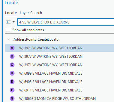

If I use the Locate Tool and begin to enter the address, I get a suggestion as I type, with no unit number.  I'm okay with that, in fact surprised since 4773 W SILVER FOX DR, KEARNS does not exist in my point data.  This locator is a single point address role. I have turned off the the other locators that load automatically with Pro.  If they were switch on, that suggestion wouldn't surprise me at all as it would 'hit' against a centerlines locator.  When I actually select the suggestion here is a partial list of what is returned:
When I look at these actual points, they all have the a  BLDG_DESIG value of 'W' .  It appears that the Prefix Direction of my address (W) is being mistaken for the building identifier.  When I fully qualify the address with a unit, it works just great:

I am not 100% sure without seeing the reference data but I think you have some units that are actually just building names such as building A or building B.  In this case you should map the Building value to the "Building Unit" instead.  For your data I would imagine it would be Unit and Building Unit that are mapped.  See the highlighted below.
We allow searching on just the building name so likely those are all pretty low scored candidates that matches the "W" as the building name.  Likely this is because one of your buildings has the name "W".

That's what I did, in the second go round.  Our field BLDG_DESIG is mostly empty but there are quite a number of them with the value of 'W'.   So I mapped it to Building Unit instead of Building Name.
Apparently there a quite a number of address points where BLDG_DESIG = 'W' ; I just did a selection for it and there are 61 to be precise.
I just don't understand:
1. Where the suggestion is coming from if the only active locator does not have that address in it
2. Where the similarity is between the mystery suggestion and the list of candidates

Nope: I got the same erroneous results as I did when I mis-mapped them.  I starting from scratch, and this time I'm not going to interject anything related to the building identifier.
