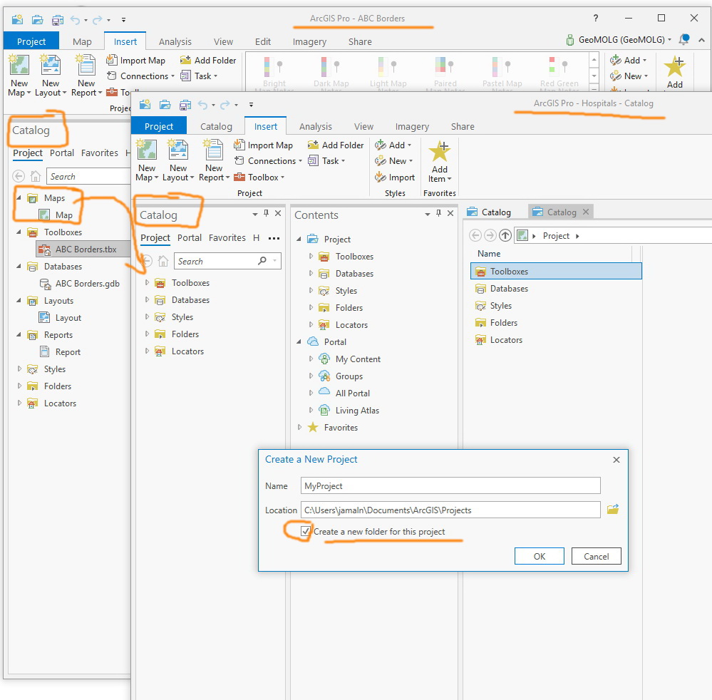

Unchecking the “create a new folder for this project” option disallows creating Map by default,
I couldn’t figure out why unchecking the “create a new folder for this project” disallows creating map by default, and thus, it doesn’t appear in the Catalog.
Is there a way to uncheck the “create a new folder for this project” option by default?

JamalNUMAN
Legendary Contributor
Thanks Dan for the input
By why checking the “create a new folder for this project” option doesn’t create Map by default? Do you think that this is something that needs to be enhanced?

Robert_LeClair
Esri Esteemed Contributor
In reviewing your screen grabs, it appears you have 2 ArcGIS Pro projects open.  One is ABC Borders and the other is Hospitals.  They are 2 unique projects so they don't see the same items such as Maps and Layouts.  To your question, if you want to create a New Project that, by default, opens a Map AND uncheck the "Create a new folder for this project", it's easy to do.  Click New followed by Map (from the Project Templates area) and fill out the Create a New Project UI.  Click OK.   The new AGP project is created (*.aprx) and is not is a new folder.

JamalNUMAN
Thanks Robert
But why the two tools below are not equivalent?

JamalNUMAN
Thanks Kory
I do support the idea that we don’t need to create gdb or txb each time we create aprx as stated in the idea you have indicated
it is just not necessary to have a new geodatabase and  a new toolbox for every single project I cre...
my point in my last post is that why the two “create new” tools are not identical in terms of output . One ends which having Map created and the other fails to do. I expect the output to be the same.
I also reported that the aprx file needs to be visible in Catalog
The ArcGIS Pro fails to recognize the .aprx file from the “project” pane,
