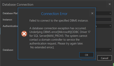

I'm using ArcGIS Pro v2.9.2
I haven't been able to create a SQL Server database connection since I upgraded to v2.9 from v2.8.
I've tried installing Microsoft OBDC drivers 17; then now I installed version 18 and still it gives me the flag that I'm trying to connect to an older version of SQL Server client communications software that is not supported.
I have two SQL Server instances I need to connect to: SQL Server 2016 and SQL Server 2014.
What versions do I need to address both instances?  Where do I download them?
Appreciate any help finding the correct versions and a link to download them from.

After the uninstall / reinstall, did you restart the ArcGIS Pro client (close / open)?
If so, did you try to reboot the machine then test the connection?
I have seen some weirdness with the drivers and a reboot was the only thing that helped.
The error above seems more of a MS error than Pro related......

Hi there. ArcGIS Pro 2.9.x supports connections to SQL Server 2019, 2017, and 2016 through ODBC Drivers 17, 13, and 13.1 as stated in this documentation.

I just deleted MS OBDC Driver 18 and re-installed MS OBDC Driver 17 and I still can't connect to SQL Server 2016 and 2014.  I get the same error
George_Thompson
Esri Notable Contributor

Hi,
How about that?  I restarted and tested my connection to make sure I can remotely connect to the server.  It worked!
You don't know how many times I've rebooted this computer.  I guess because I did a "clean" install of the OBDC driver again, it somehow worked this time around.
Thanks for the suggestion.  I was about to give up on this.
