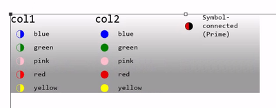

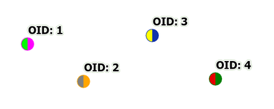

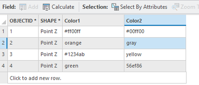

Try allowing symbol property connections (Attribute driven symbology) .
For example

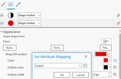

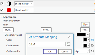

To get this, I set it to use Symbol Property Connections
Then, for each symbol layer, I set the color property to be a given field in my table. (Note the blue database symbol-- that means that property is connected to an attribute)
In your case, you'd probably want to use an actual arcade expression so you can match colors to certain values, like
if ($feature.column1 == "School"){
    return "#00ffff"
}else{
    return "000000"
I use this sort of thing (not for color, but I wish I had-- that'd've been easier by a lot) pretty frequently, e.g. setting labels or drawing the radius of a circle dynamically as part of the symbol. Huge shoutout to @JohannesLindner for figuring that out for me.

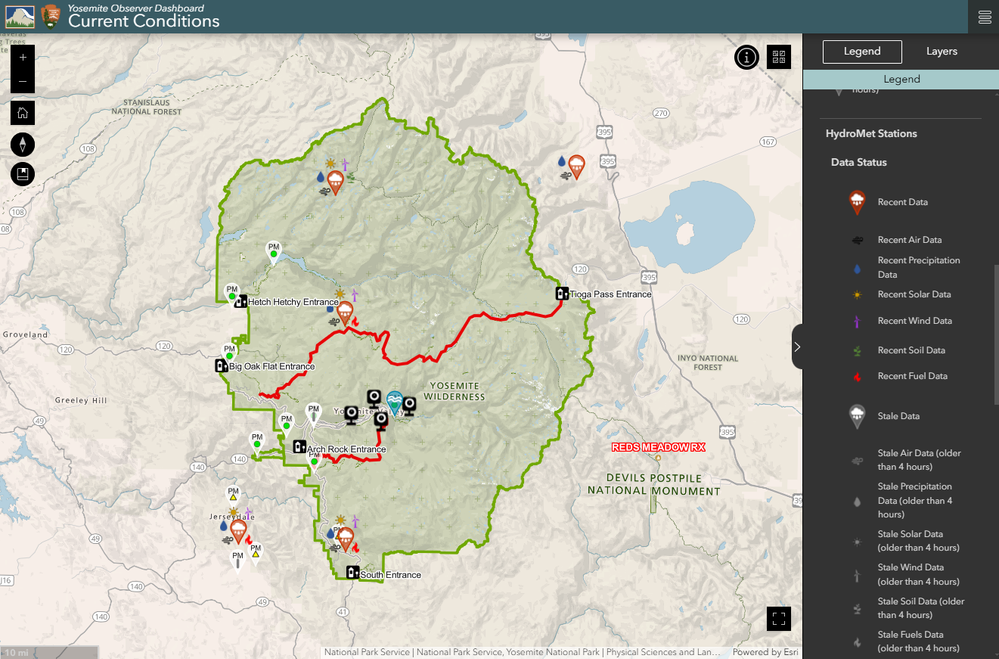

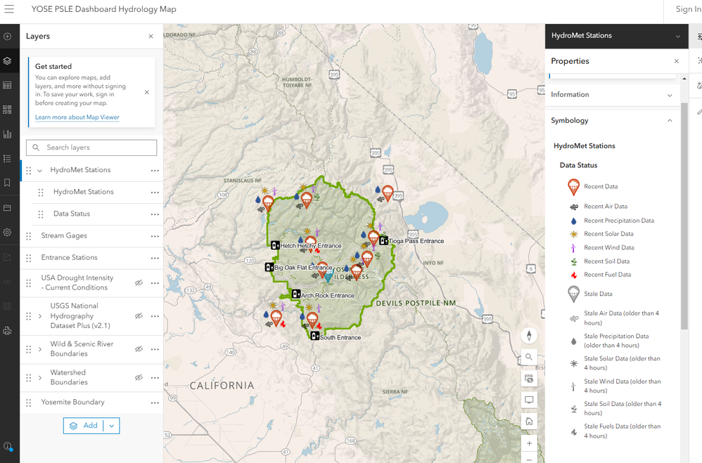

Because currently there is no legend support for layers using the Dictionary Renderer, I have seen other examples of customers doing this (option 1 - create another layer with a unique value renderer of specifically the symbols you want in your legend) which have turned out pretty well.
This is a public example from the National Park Service in Yosemite. They used this web map in a dashboard. You can see the `HydroMet Stations` group layer has two layers in it... one is `HydroMet Stations` (which is the real data used with the Dictionary Renderer) and the other is `Data Status` which is an empty layer with symbology set up in a nice way specifically for the legend. I think this turned out nicely in the app and actually gave them a more specific way to show these multi-attribute status symbols without having to show every permutation as a separate symbol in the legend.
