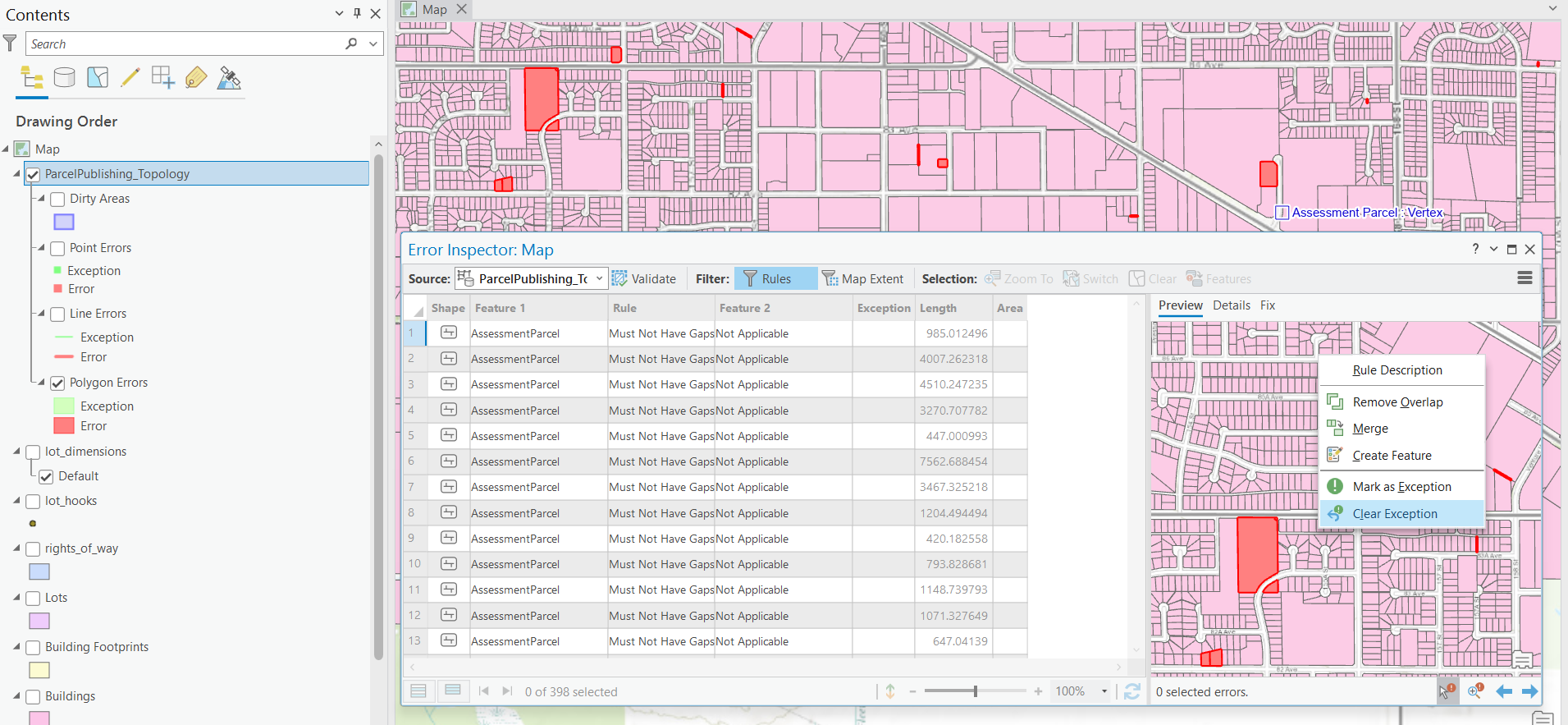

I am using ArcGIS Pro 3.1.2 and trying to use the Error Inspector to validate and fix the topology errors in the geodatabase I am working with.
However, when I opened the Error Inspector View and clicked anywhere on the error table, it didn’t allow me to select any specific error (see the screenshot below, the error table on the left is greyed out and doesn't allow me to click on any errors). I can only click on an error through the map in the map view (see the map on the right). But even an error was selected on the map, the corresponding record was not highlighted on the table as it was supposed to be). When I clicked on the Details tab, it always shows the details about the first record on the error table.

Hi CX!  I have not seen this behavior before - interesting...
So a few questions for you:
1.  What release of ArcGIS Pro are you using?
2.  Is your data in a File geodatabase or an Enterprise geodatabase?  If a file geodatabase and someone else is editing the data, then a schema lock would prevent you from editing the data/topology.

Hi Robert,
Thank you very much for your reply. I am using ArcGIS Pro 3.1.2 and I am working on a file geodatabase. After I restarted ArcGIS pro, the problem was resolved. Thanks!
