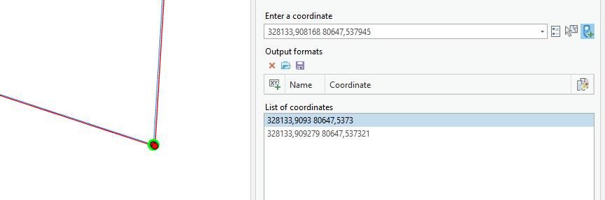

Hi,
can i change the resolution/tolerance xy of the tracing tool for tracing a feature. I get coordinates like 328133,9093 80647,5373 when i trace a feature. What i need is a precision of 328133,909279 80647,537321.
So could i increase decimal places from 4 to 6.  Both features have resolution/tolerance xy that could handle this.

When you mention that you see the coordinates with 4 decimal places, what environment/situation is this in?

I'm using EPSG 31255 in the map. After tracing the vertices that are created have only 4 decimal places. I know that such a precision is not measurable, but I want that all lines and vertices lie accurate on top of each other. The coordinates of xy in this coordinate system have 6 decimal places, so i want this kind of accuracy, with snapping and tracing.
