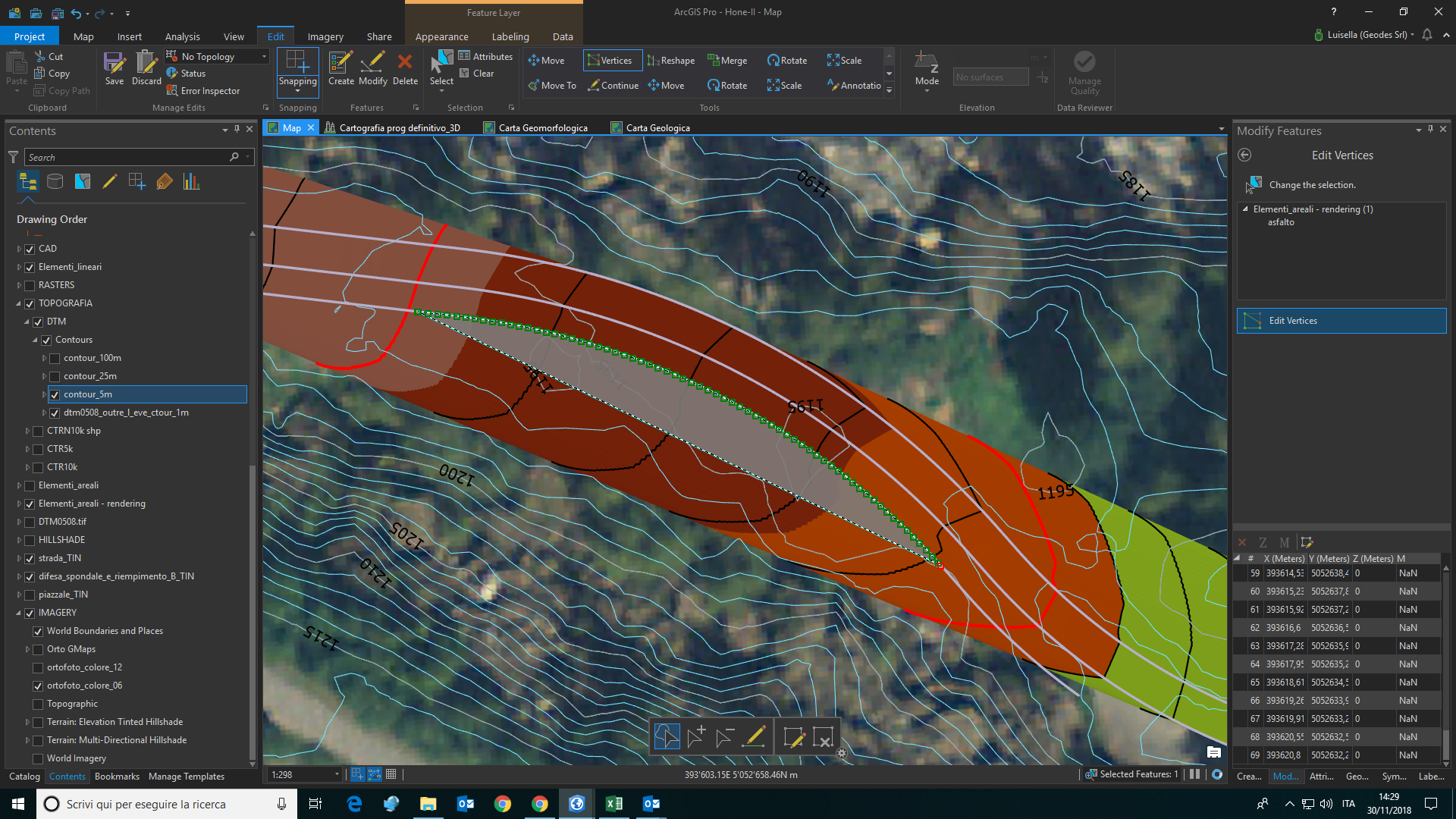

I have a polyline 3d feature which I want to trace to create some polygons.
Why the z coordinate is not traced (snapping is ON)? Is this not yet available?

I do not want to specify elevation. I would like it is fetched from the traced object, but it is set to 0.

I do not agree. In maps, with Z-mode off and snapping on, the behaviour is as follows:
new features fetch the elevation (if available) from snapped feature
  • new features created with "trace selected features only" always set z to 0 even if traced features had z values <> from 0

Ivano,
As you suspected, this is not available yet in Pro. When tracing features with the elevation mode off, the resulting segment z values are 0. We'll work on it after 2.3
