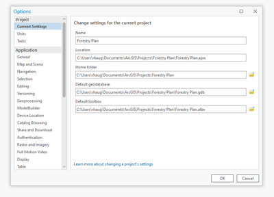

Once you have the project open you can maneuver to the top left hand corner, click on Project and then click on Options. This will be revealed:

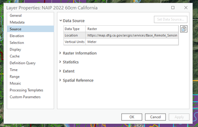

If you're looking for the file location of a feature class, click on the feature class, then right click and select Properties, the click on Source. This will be revealed:

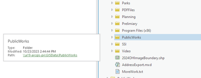

You can hover over the file/folder in Catalog and the popup will show you the path:

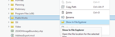

or, right click the folder in the catalog pane and choose "Show in File Explorer" (or "Copy Path"):
