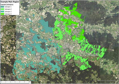

colors_example.PNGI never thaught about using Arcade and i am not familiar with it but after a little research it sounds that it could do it.
Here is an example of a map with four subregions with too similar colors. (Its not that bad, there are also cases that are harder to distinguish.) Of course, if you look closely you can distinguish all green tones but it would be clearer if the four subregions would be in red, blue, yellow and brown for example.
So do you know how to adjust these colors for the whole map series in Arcade?

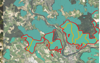

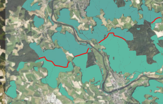

Alternately, when I look at your example data, it looks like the subregions are roughly contiguous, relative to themselves & each other.  The difficult part, here, is really just the border between subregions, shown with the red line below:
If you have some way of clearly symbolizing that border line, that'll make even pretty similar colors suddenly pop as distinct.
There are several ways to do this with varying levels of results.  The cleanest would likely involve a separate vector program like Illustrator or Inkscape, which is likely not realistic for 100+ main region maps.
But you can get close to this with the Merge Rules in the symbology pane; I'd read up on those, and how they work.  Put a border that only shows on the outside of the region, and not on adjacent sub-polygons within it.
You'll likely end up with borders around each of the "islands" in your polygons (again, red lines), but not the lines that seem to be between them (yellow lines):
