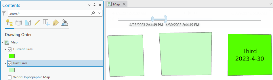

From the picture it looks like you want all the fires that have happened up to the current time point to draw, but only the fires from the current time point to label. In order to do that, I'd create 2 layers in the map - one for the current fires that will be labeled, and another for past fires that will not have a label.
Current fires layer: Configure the Time settings on the layer to use the date field or fields to draw the fire only when it is active. This layer will be labeled so labels are only drawing when the fire is active. This can be configured to draw based either on a single date field or a start date and end date fields, depending on how the fire data has been recorded.
Besides limiting the labeling to the current layer, this also allows you to draw the current fires in a different style than the past fires to emphasize the current fires in each frame.
Past Fires layer: In order to draw the fires that have occurred up to the current time point without labels, the past fires layer will have time settings configured with both Start Time and End Time fields. The End Time field will not be the fire's end date, but should instead be the current date or some date after that last date in the fires dataset. To start, create a new field and calculate it with that end date - let's call it DatasetEndDate.
Next, configure the Time settings on this layer so the Start Time field uses either the fire start field (if the fire data has both start and end dates) or the single fire date field. Then the End Time Field will be set to the new DatasetEndDate field you created. This artificial end date ensures this layer keeps drawing on the map after the time the fire stopped burning.
Here's a sample of data using these 2 layers with different time configurations settings on each.
