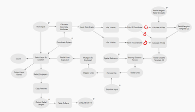

This is what the model looks like, in case that helps find a solution.

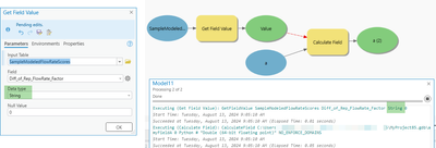

Could you please try to change the Get Field Value tool Data Type parameter from "Double" to "String"?
When the Data Type is set as Double, Long, or Boolean, the precondition link considers value 0 as false.

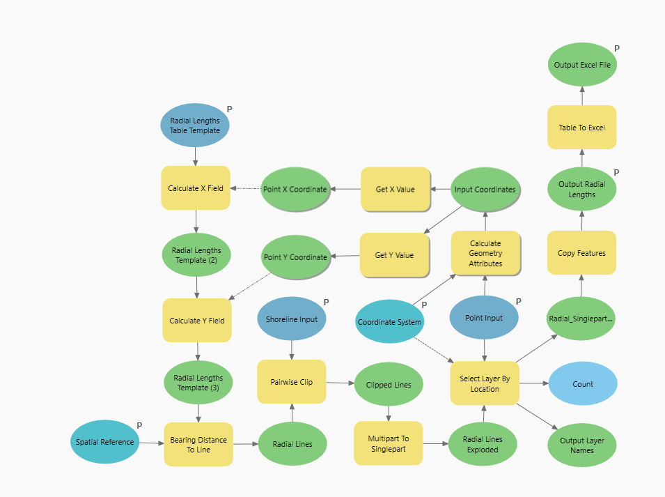

It may help to lay out your model from left to right so you can more easily see the sequence.
It looks as though that branch that starts at Radial Lengths Table Template doesn't get to run because it depends on things that have not executed yet.

I've reorganized the layout, hopefully it's a bit more clear. There are pre-condition arrows to force other processes to run before the radial lengths table template can be used.

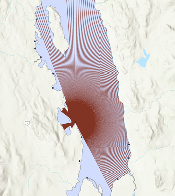

The funny thing is that this model actually worked perfectly before, but for some reason doesn't work anymore. Here's the correct output it generated previously:
