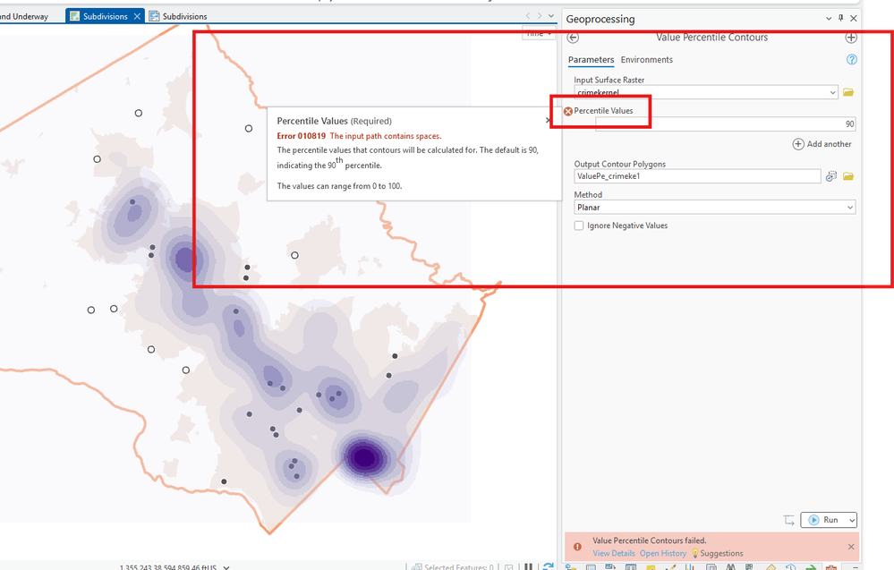

The output path contains spaces. - Is this a bug?

C_McNamara
The Dan! My input dataset is perfectly fine - not getting an error for my input surface raster. The error is coming from a numeric input parameter value associated with a Percentile Value(s) that contours will be evaluated for. The default value is 90, which is what you see inside the image.
DanPatterson
MVP Esteemed Contributor
I saw that, but it is the error number that is being thrown regardless of the spatial analyst tool being used.  I couldn't tell if your raster was an esri grid or a raster in a geodatabase (since there is no *.tif extension, for example).  If it is an esri grid, then the path cannot contain spaces.
The fact that the red x occurs on the line where the percentage threshold is located isn't related to the error message.
There is nothing related to that particular tool in the public facing suppor site, only errors relating to spatial analyst tools and that particular error number.  Tech Support may have access to non-public causes for this error if my suggestion still doesn't pan out.
Good luck

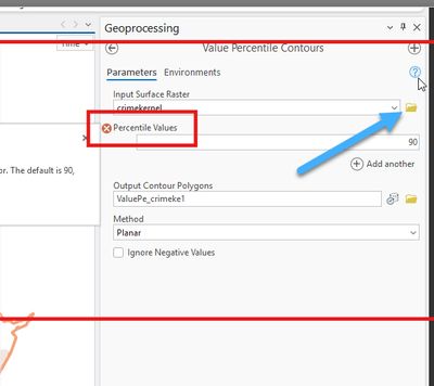

RhettZufelt
MVP Notable Contributor
do you still get the error when you click the folder button and browse to the input surface, and NOT select it from the dropdown?

RhettZufelt
saw that, but response had no indication that it was tried.
