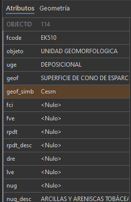

I have any polygon that has an attribute table with data from that polygon,
And when I split it with the SPLIT tool, it deletes all the information contained in the attribute table of the two polygons.

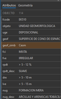

And what I want is for the information to be maintained in both polygons.
I would greatly appreciate it if anyone helps me. Kind regards
