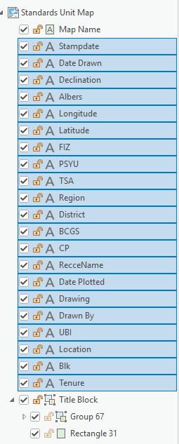

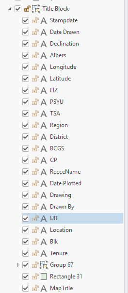

Hullo.  On the latest greatest ArcGISpro 3.5.  I have a project layout that has several text element in its title block that are updated with an Arcpy script.  If the text elements are grouped witht he rest of the title block, it takes about 2 seconds to update each element.  If they are not grouped at all, the update happens neatly instantly.  I would like them grouped as I need to move the title block around to accommodate different plot sizes.  So this is slow...
and this is fast....
