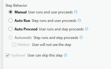

Heather_Campbell
I got this error to go away when I changed the Step Behaviour from "Auto Run" to "Manual".
