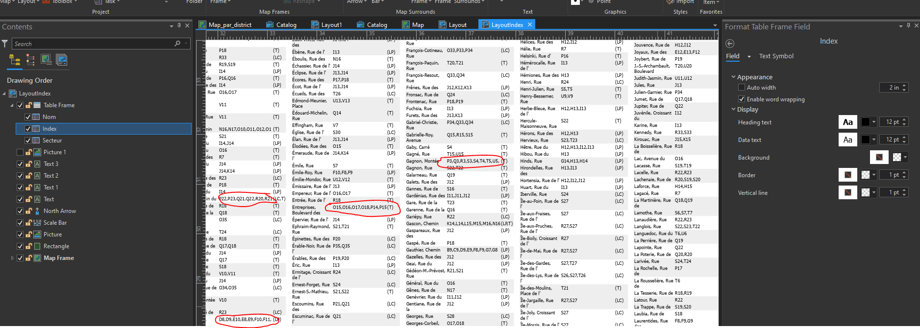

Unfortunately the table is not part of a group. Maybe it's due to the content of the field?
Here is a print screen . The elements in red should have been on several lines because they are incomplete
Thanks for your help.

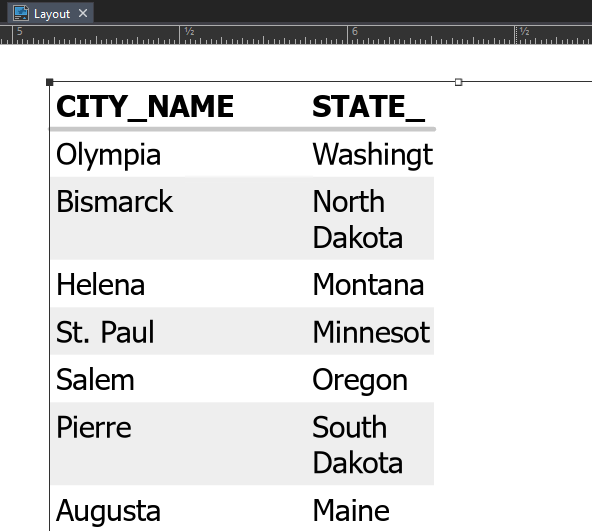

Thanks for the screenshot.  It appears that for the values circled in red there is no space in which to break the string. Word wrapping is not designed to break continuous string values.  For example, here is a table with US state names.
If I set the "STATE_NAME" column to be 0.6 inches with word wrapping enabled...

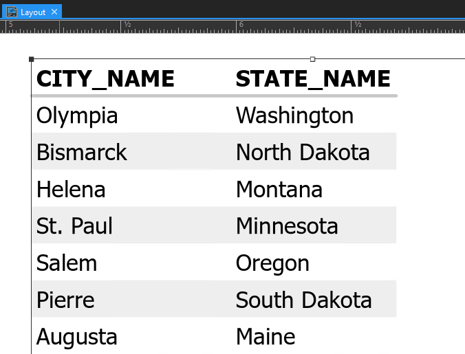

... I get the following result.
"North Dakota" and "South Dakota" wrap to a new line because there is a space between characters in which to break and wrap the string. Other text such as "Washington" and "Minnesota" are not wrapped because there is no space available to break the string.the
In order to word wrap you will need to provide an appropriate space within the text string you want to wrap.

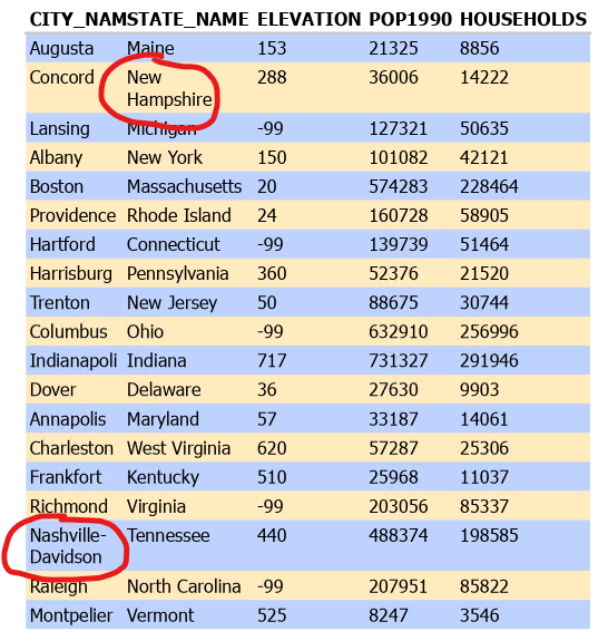

You are right. I replaced the commas with spaces:
I will keep this in mind
