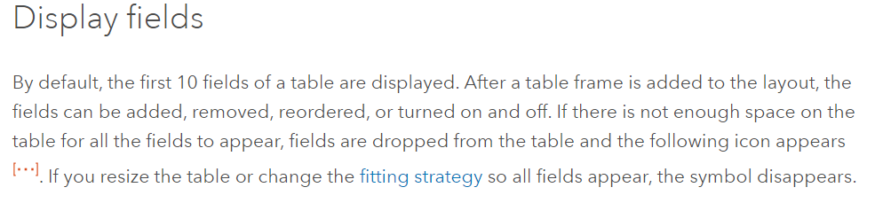

To maximize performance, after all some tables have hundreds of fields, table frames will display up to the first 10 fields when the table frame is first inserted onto the layout. You can add additional fields or remove fields using the context menu off the table frame element in the Contents pane.
Here is the relevant from the help topic https://pro.arcgis.com/en/pro-app/latest/help/layouts/add-and-modify-table-frames.htm:

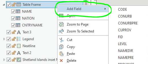

 Here is a screenshot of the Table Frame context menu with the Add Field option highlighted.
Hope this helps.
Tom
Hope this helps.
Tom

Thank you, I was looking for this option elsewhere but never thought of right-clicking the element. This solved my issue.
