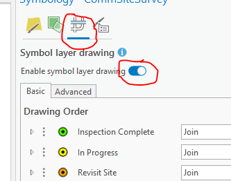

RobertBorchert
Honored Contributor
Click on the Symbol Layer Drawing Tab and turn on Enable Symbol Layer Drawing
