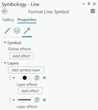

1. Click the symbol in the Contest pane or the Symbology pane to open the Symbology pane and click the Properties tab to edit the line symbol.
2. Click the Structure tab (wrench icon) and then Add symbol layer > Marker layer to add a new Marker layer for the hexagon symbol.

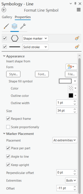

4. Edit the marker symbol to make the hexagon symbol and edit placement of the symbol with these settings:
  • Uncheck Scale proportionally
  • Marker placement: At extremities
  • Check Angle to line
  • Check Keep upright
  • Extremities: Both
  • Offset: -11 (or whatever distance places the hexagon boundary at the end of the line)

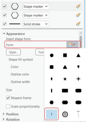

6. Back on the Layers tab, select the top Shape marker and change the Form to the bottom-left option in the menu.
7. Configure the Shape text symbol properties to make the symbol look the way you want.

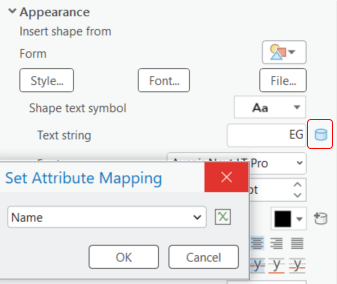

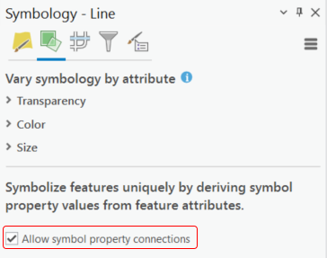

8. If the text for the given symbol is always EG then just enter 'EG' in the Text string property and you're all set. If the text will change from feature to feature, Enable feature property connections on the symbology.
Then go back to edit the Shape markers of the line symbol and there will be a little database icon next to the Text string field - click that and specify which attribute the text will come from, or write an Arcade expression to output the desired text to be placed in the symbol.
