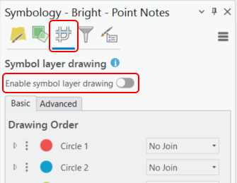

JesseWickizer
Enable Symbol Layer Drawing on the layer to control the drawing order of symbol classes in the layer.
