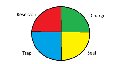

Hi,
I got a fairly simple question that I struggle to find the answer to.
The user want to use certain colour in a pie chart looking symbol.
I tested with unique values and "Circular sector effect" to define the correct areas, but didn't find the correct data setup.
This is an example of the dataset:
WellnameSealTrapChargeReservoir
123/12-53421
456/12-61224
789/12-72112
1=Red
2=Green
3=Yellow
4=Blue
The idea is to have the four categories Trap, Seal, Charge, Reservoir in pie chart looking symbol, and based on the different values (1-4) colour the sector with certain colours. So when you move around in the map you would see the different wells with different coloured pie charts.
Do you see a good way to solve it within the same layer instead of having multiple layers with definition queries?
I have also attached an image showing one example from one well.
Thanks!
NoAndy
Solved it by making the symbology manually
