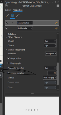

I have a long line made up of many 2 ft. lines that have coincident end points. I want to put on a marker symbol that shows line direction, but I don't want a marker symbol on every segment since they are only 2 ft long. I want a marker symbol on say every 20th segment, or even just have one every so many feet. My main concern is learning how to put a marker symbol on the line work that keeps some kind of predetermined distance along the line from each other.

When I have 1 really big line I can change the frequency of arrow by altering the placement template
I tried this with a bunch of connected segments and it seemed to help.
