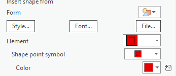

  5. Go to the wrench tab and add a new marker symbol
  6. Switch back to the layers tab and change the symbol to an appropriate one. I chose a motorcycle for the bike field, for example
  7. Next to the "Size" parameter, hit the GDB icon
  8. Hit the Green X button
  9. Input the following code (change the field to match your field names)

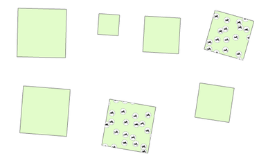

So, what we did was say "If this field is empty, make the symbol size 0". When the field is not empty, it will match whatever size you normally have in the size field.
Taking this, we can go back to the wrench tab and duplicate this symbol layer
and change the symbol and the field we're checking each time.

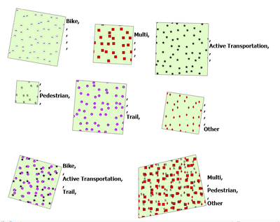

And then we get this as the output
Be careful if doing random points to change the seed value each time, and change the spacing in general, or else they all end up on top of each other.

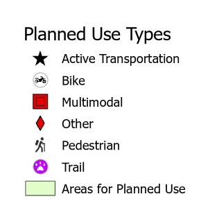

This is going to look awful in your legend.
There are other ways to do this, but I'd suggest making a dummy point feature class with a name field and 5 points.
  1. Update the name field so each point matches your symbol classes
  2. And change the heading to say like "Planned Use"
  3. Now, duplicate the polygon layer and turn off all the points
  4. In your Layout, change your legend's properties so that the "Layer visibility" box is unchecked
  5. Turn off or remove the layer with the symbology from your legend
  6. You now have an OK-looking legend.
