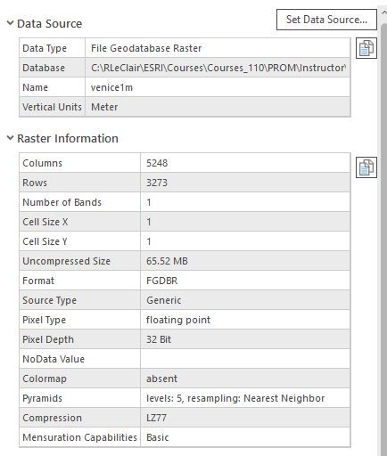

GREAT!  Okay, next step.  Here is my Data Source and Raster Properties below.  I'm thinking you're working with a raster dataset that has more than 1-band. That's why you're seeing RGB, Stretch and Vector symbology options.

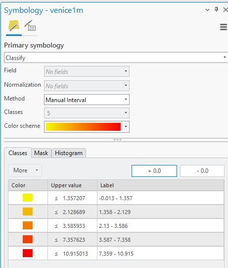

So if I'm understanding the question correctly, you want to break the symbology of a continuous raster dataset into say 5 classes for discrete colors.  If this is the case, click the raster layer in the Catalog Pane, then you'll see a contextual tab on the  ribbon that says Raster Layer.  On the Raster Layer tab, in the Rendering group is the Symbology tool.  Click that.  In the Symbology Pane, select Classify for the Primary symbology, choose your classification method, set the number of classes you want, choose your color scheme.  On the classes tab, you can set the upper value for each class or click the Histogram and manually set them there too.
KeithAddison1
You've got it right. Classify just doesn't show up when I click the symbology drop down, it just gives me RGB, Stretch and vector field. Possibly a limitation with the sid file format? Not sure what generation it is. I loaded a tif in the same map and Classify does show up.
KeithAddison1
Yep, this raster shouldn't have two bands but does for some reason.  Thanks!
