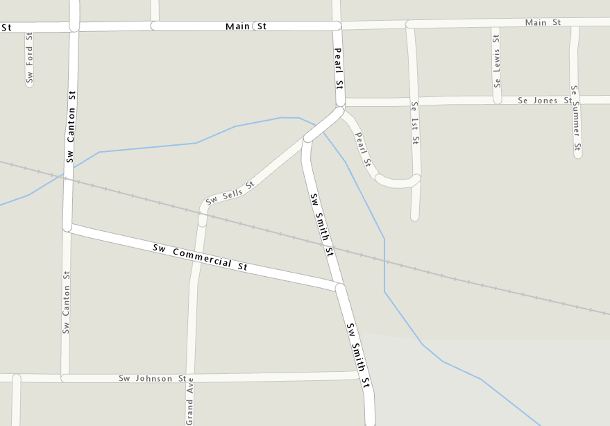

How do you join/merge line symbols in ArcGIS Pro?  For example, in the screenshot below my roads are symbolized individually and I'd like them to join/merge to show contiguous road segments.  I found Symbol layer drawing, but that doesn't seem to do any joining/merging, just sets the drawing order, unless I'm missing something...

you can do this - just use symbol layer drawing and order the fills so they merge, as per the help:
Symbol layer drawing—ArcGIS Pro | ArcGIS for Desktop
  • You can blend the symbology for connectivity where streets intersect so you can represent overpasses or underpasses and have line casings where one category of road properly meets another class of road. To achieve this, organize the symbol layers so the symbol representing the filling of the streets is ordered in a group above the outlines of the streets.

Take a look at the screenshot below.  This is what I have found works in ArcGIS Pro.  I moved all the bottom line markers into a new group, placed that at the bottom, and organized the symbols in the drawing order.  I then organized the top line markers (original groups) in the drawing order I desired.  This resulted in joined/merged lines.
There could be a better solution within ArcGIS Pro, but after looking at layers from a mxd I imported, this seemed to be what was done with those layers that were drawn already joined/merged from the imported mxd.
