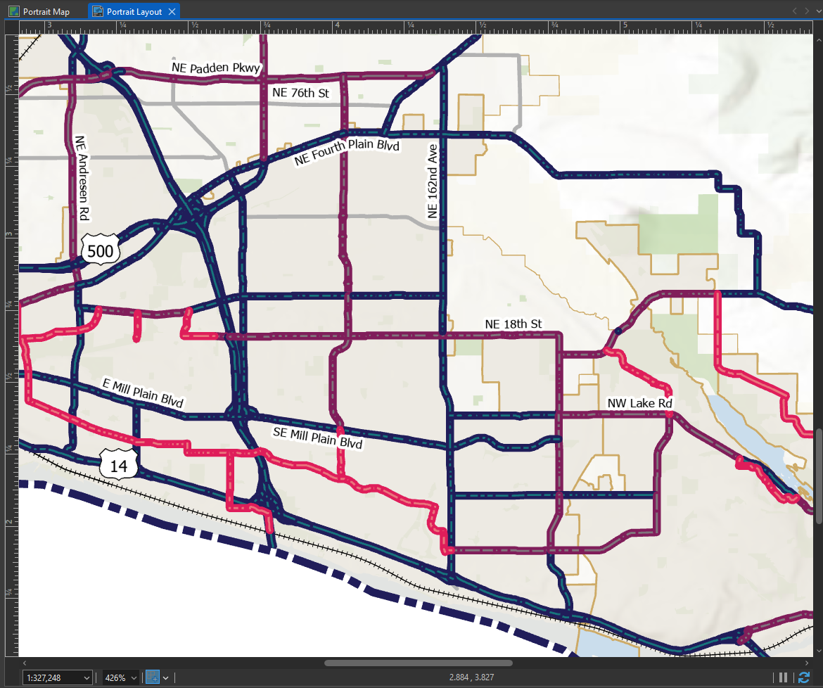

It's best viewed from the layout pane. Below is what it looks like when I'm "only" zoomed in to 426%:

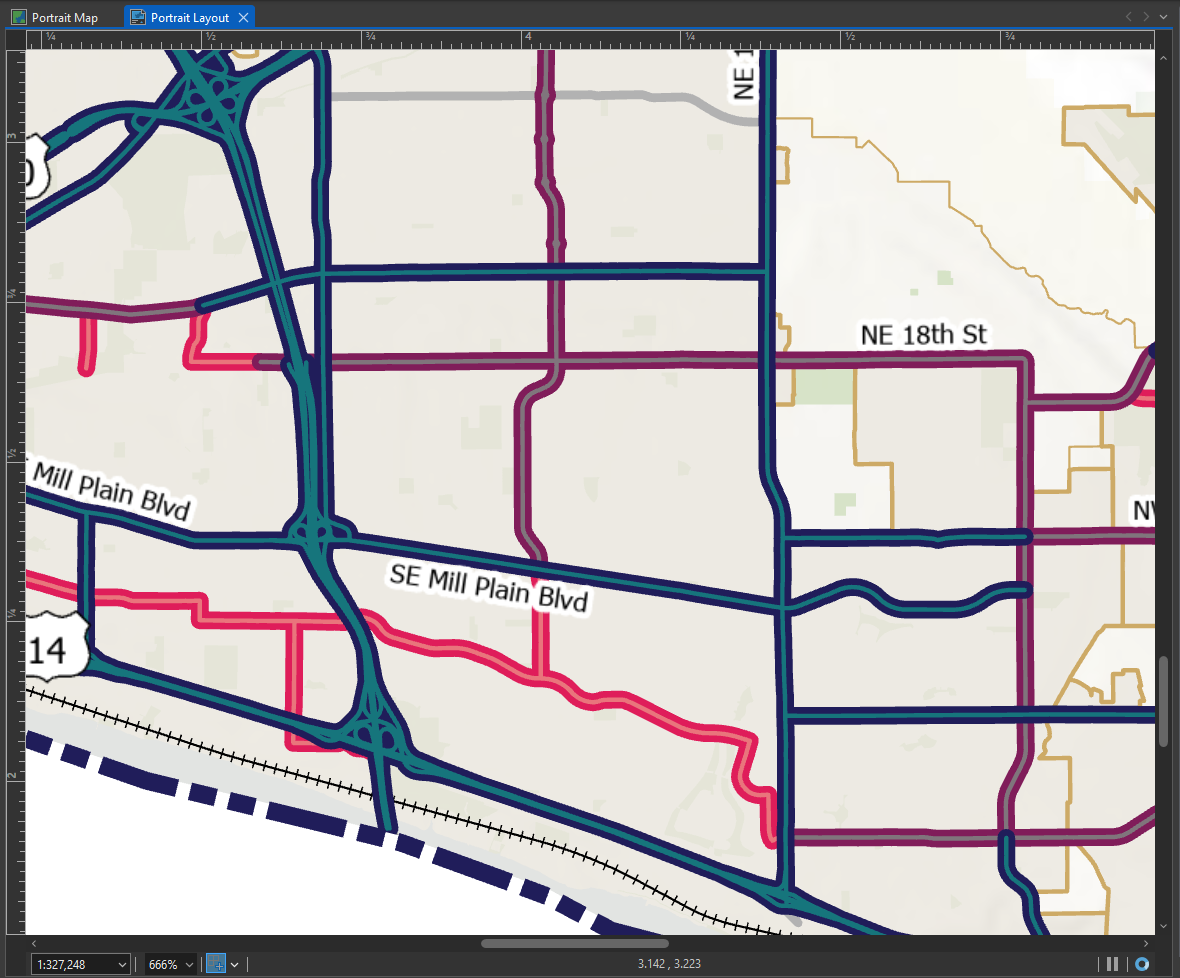

Here is what it looks like when I'm zoomed in all the way to 666%.
In the map view, it seems the "threshold" is 1:99,999. At that scale or beyond (+ 99,999), the symbol layer drawing turns itself off. I have been looking through all the menus I can think of to try and locate where the setting could be but I have been unsuccessful in finding anything. Hence why I've gone so far as to ask here.
