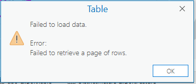

Edit 2: I've tried to join the table again a few times (after removing joins), now I can't open the polygon layer (dataset 1) at all, I get this error:

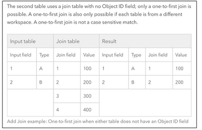

  5. For what it’s worth, I suspect the join is one-to-one (one-to-first) because the tables aren’t in the same workspace. If they were in the same workspace, the join would be one-to-many.
    Add Join (Data Management)
    A one-to-first join is also only possible if each table is from a different workspace.
  6. Does the second table have an ObjectId column? I suspect no, if it is not registered with a geodatabase.

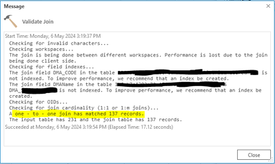

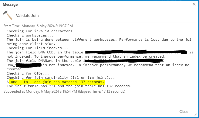

  19. As you’ve hinted, it’s strange that the messages in the screenshot indicate that matches have been found for 137 records, yet the attribute table is not showing any matches.
