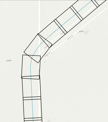

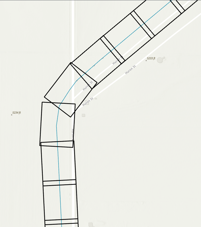

Here's the typical Strip Map Index (not good = angled):

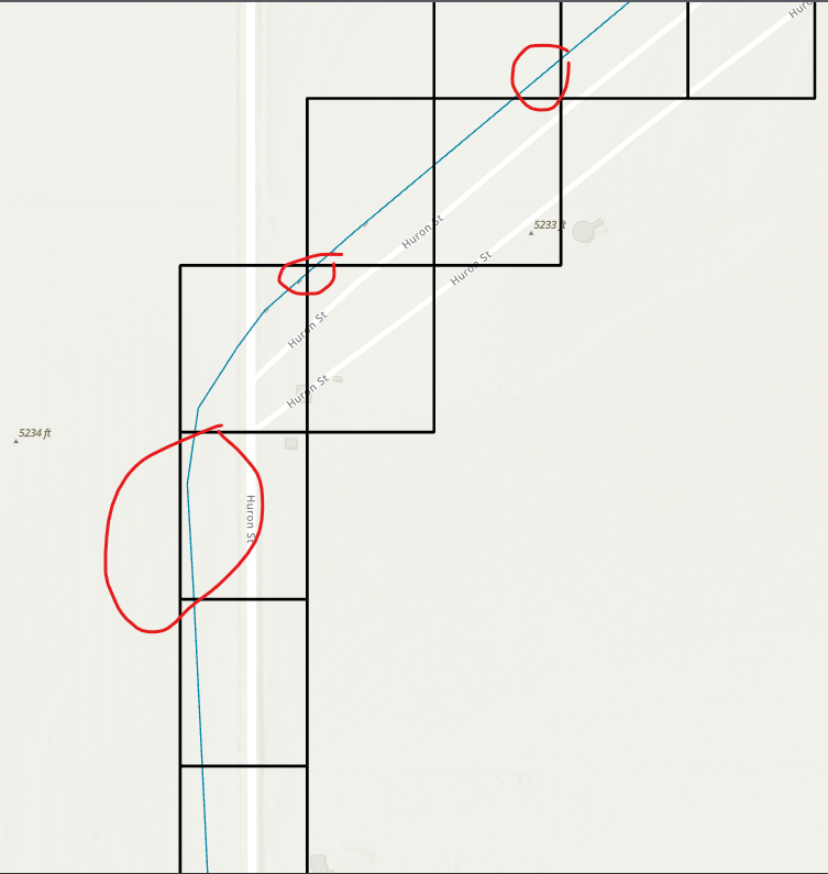

Here's the typical Grid Index (not good = weird line coverage):

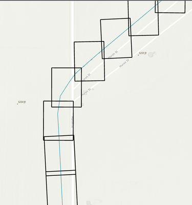

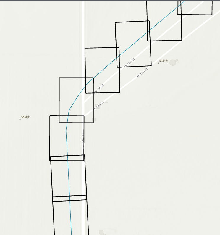

Here's what I want (approximately):
The main difference from the grid index is that I want the overlap to be variable in order to get the best coverage of the feature.
