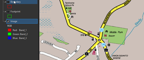

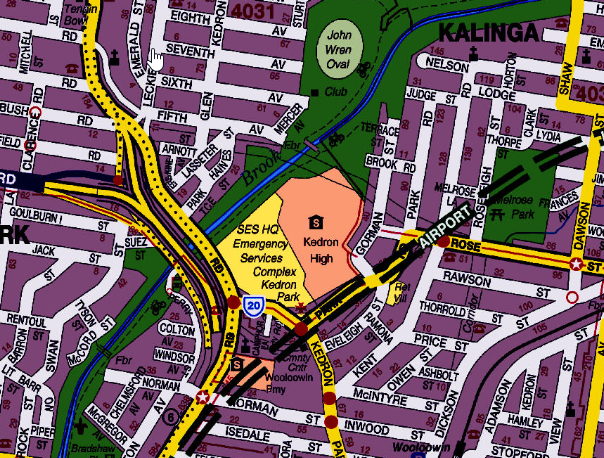

I created a mosaic dataset of street map images (locally purchased street mapping) in ArcGIS Pro 2.7 then created a tile package of the mosaic.
I turn the Stretch Type to None and save the Map and it appears like the first screen capture below.   When I then generate a tile package off the map I get the second image below.  No matter what I do to the symbology I still get pretty much get the purple background.

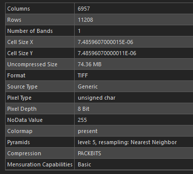

I think those original images might be using a colormap. Can you check the properties of them under Source - Raster Information and find out what is under Number of Bands, Format, Pixel Type, Pixel Depth. Have you tried different output formats when creating the tiles - PNG8, JPEG etc.?
PeterKT
You're right, they're a 1 band colormap.  They are a product that most people see as a physical street map book and we receive them as TIFs.

I might have got you off track there. I've got a mosaic dataset that successfully reads the 1 band colormap images in and creates valid 3 band overviews. If I turn off the stretching it all displays as expected. When I go to tile cache it, it turns the stretching back on.  Doesn't matter if I target png8, pngs or jpeg in the tile cache.
