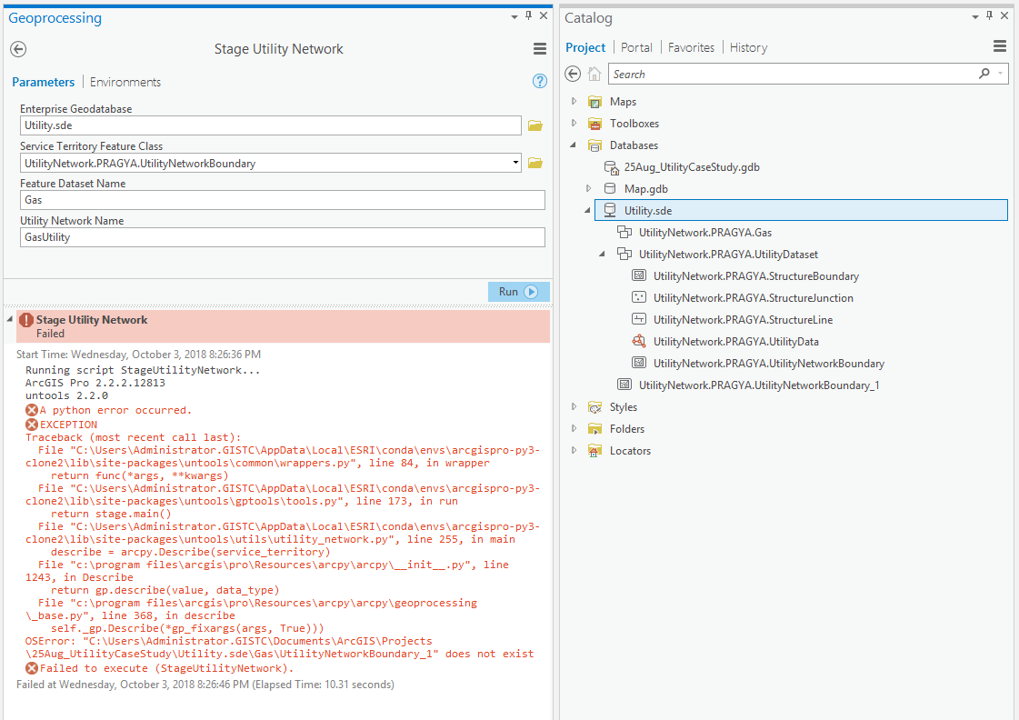

I am trying to run 'Stage Utility Network' tool and getting following error:
I have no idea why I am getting this error. Makes no sense to me.

Just an update! I was getting this error because of a bug that ESRI plans to resolve by the next release.
-Pragya
MelissaJarman
Thanks Pragya for posting back!
Here is the bug information for those that want to see additional details like the workaround.
BUG-000115745: The Stage Utility Network tool fails when service te..
Workaround: Place the service territory feature class in a file geodatabase instead of an enterprise geodatabase.
