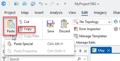

@Stephanie-Ingraldi The Duplicate Vertical and Array tool are expecting something other than an offset of 0. We wanted to prevent cases of unwanted duplicates. As far as getting duplicates, I assume Copy > Paste isn't a desired workflow for you?
For what it's worth, you can click Paste as many times as you need. Maybe you need hundreds of duplicates?
