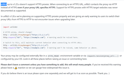

I found a solution for arcgisPro 2.9.2. In my project we use the arcgis.gis.server.server() to make the new request see https://developers.arcgis.com/python/api-reference/arcgis.gis.server.html. In there there is a parameter that is setting the difference between HTTPS and HTTP. Apperantly the default is True (or it needs to be explicitly mentioned to be false). In my case adding the parameter to false fixed the problem. It would be better of course to use the HTTPS.
The real root cause is the update of the Urllib3 python library.  In v1.25.x HTTPS was not supported and every hTTPS call you did was transformed to HTTP. But in v1.26.x  is is supported and you should update your calls. I suppose Arcgis Pro 2.7 has the 1.125 version and the 2.8/9 had the 1.26 version but I haven't checket that.  https://github.com/urllib3/urllib3/issues/1850.
