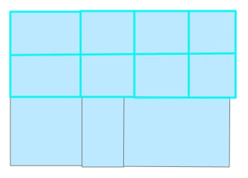

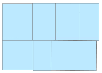

Hello, I'm using ArcGIS Pro 3.1, and it doesn't appear that the Split tool is working across multiple selected polygons.
For example, I have multiple coincident polygons that I'm trying to divide using the Split tool.  They are all selected, and I draw the split line bisecting all of them.  The tool only divides the first polygon encountered, and ignores the following.
In ArcMap, this tool could divide multiple polygons at a time.
Is this a bug? Am I missing something simple?

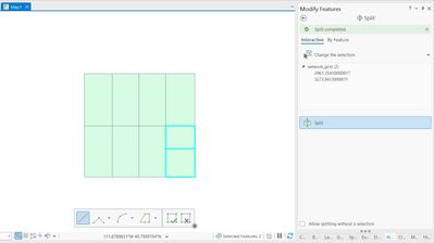

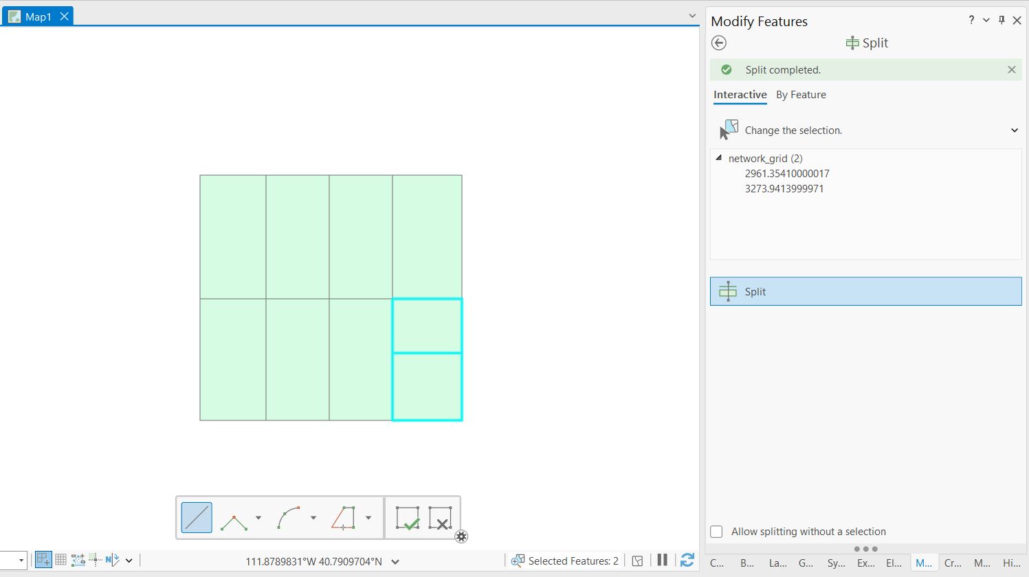

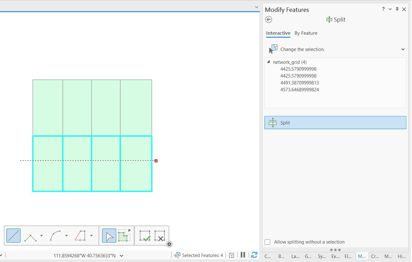

Below, Drawing a line to split multiple selected polygons (Allow splitting without a selection is unchecked)
The Result:

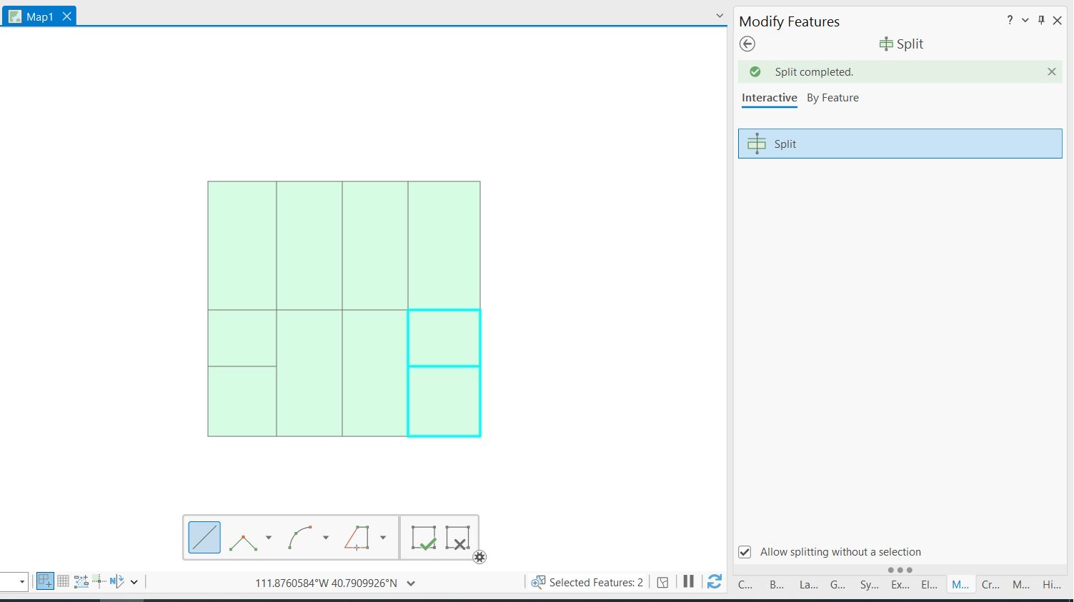

The result when attempting the same process with Allow splitting without selection checked. (This was done after the first test, hence the two sets of split polygons).
