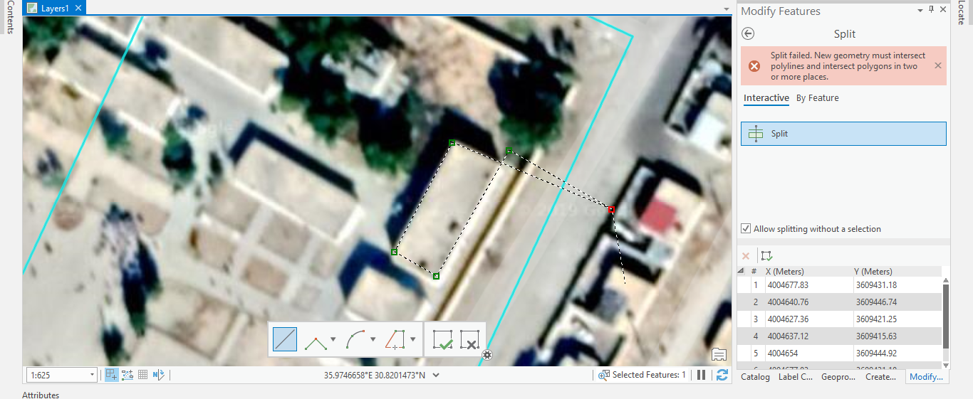

Please, I need help, I've been using ArcGIS Pro v. 2.3 for Digitizing buildings polygon feature class and When I use Tool called "Split" From Modify Features it still gives me the error in the image below "Split failed. New geometry must intersect polylines and intersect polygons in two or more places"
how can I use this tool in the same efficiency of use it inside ArcMap software?
Error in Modify a polygon feature

it looks like you want a 'clip'.  You want a sub-area of a larger polygon.
A split has to go across a polygon boundary entering and exiting at two points resulting in a 'left' and 'right' side

Yes, thank you But I remain will need a Reshape for the feature after the split it. another wise use of the Split method using ArcMap is very helpful. what I need who to use the split method in ArcGIS Pro in the effective way same as ArcMap?

You will also get this error message if you do not select the feature before trying to split it.

  1. Select all polygons or polylines you want to split.
  2. Click once outside at the start/before the first line/polygon
  3. Click once outside at the end to create a vertex in the split line.
  4. right-mouse-click 'finish' or you can double-click left mouse (if you have enabled double-click as a shortcut for the finish button)
It's slightly different behaviour to ArcMap as I think the double-click will add a vertice AND finish it for the split. ArcGIS Pro will require a vertex placed first.
I was getting this error all the time when I knew that the line for splitting was past what I wanted to split. The error tells you that the last point you place a vertex is still inside the polygon.
