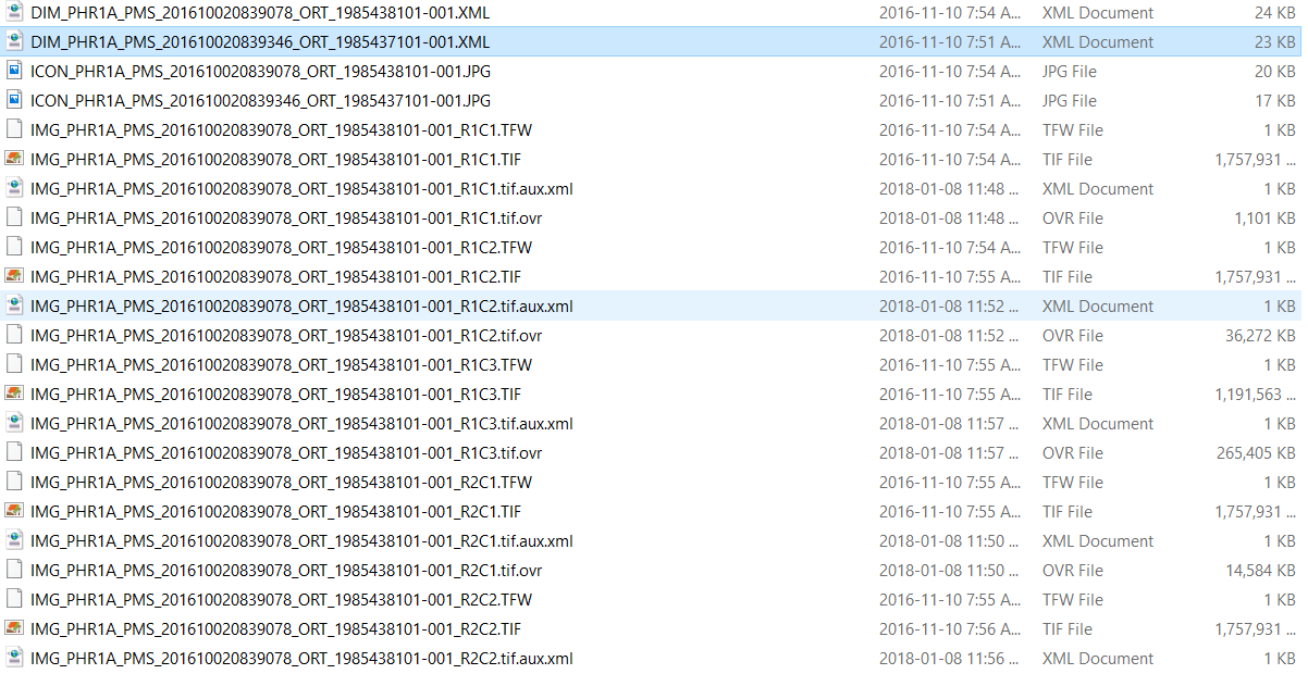

The file I'm doing the classification on is an XML file which I believe points to several tiles - each having their own .tif, .tfw. .xml, and a .ovr file. I've attached a screenshot showing the files.
image of files

Well they are big, and I am sure that if you are using your system monitor, that the hard drive useage is probably quite active.
Processing in batches, mosaic dataset (others can wade in on that) may be your only solution.  I also suspect 16 Gig should be the new minimum since your operating system and browser can suck up a lot before you even get going
