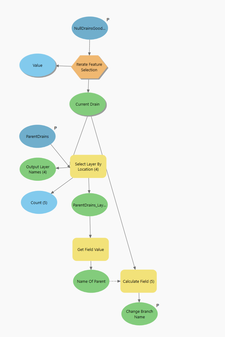

This is the sub model that is causing the slowness. I tried adding a spatial index to it's input before feeding it in hopes of speeding things up, but as you pointed out, that functionality is not supported:
For context the model goes through a data set of lines, sees if lines from another data set intersect it, and if they do, it inherits the name of the first one. If there are any other ways to speed the process up please let me know. I'm currently working on making a script that splits the data set into smaller chunks and runs this tool in parallel to hopefully speed things up, but it is complicated so any help would be appreciated.
 It was tried and tested and it used to run really fast before. I added some operations to it, which turned out to be unnecessary, so I ended up removing them, resulting in the original model. For some reason in the past few days, it seems to run very slowly, with functions like calculate field and select by location taking much longer than before. Even something as simple as get field value started taking multiple seconds in a different variation of this model (same data set type input, simply blank names in records.)
Thank you very much

I would try converting your model to a script, it may speed some things up, but the biggest factor would be running your model in a trimmed down project.  New project... just the needed data... run it and compare to your existing scenario.

Tried doing that. Unfortunately it didn't work. I think it might be caused by an internal issue within the model/ its variations and the way they interact with each other. Going through each of them yesterday I found some mistakes that had been correct but I don't think the edits went through. Might be because of how frequently I would have to force stop ArcGIS from the task manager when I lost the progress log tab. I'm pretty sure that I need to thoroughly review the models at this point to find any discrepancies. I'll post again if I find a solution and remember 🙂 Thank you for your help.

One thing I did find is that Get Field Value and the other tools seem to take more time with each iteration. If you know of a way around this I would really appreciate it.
