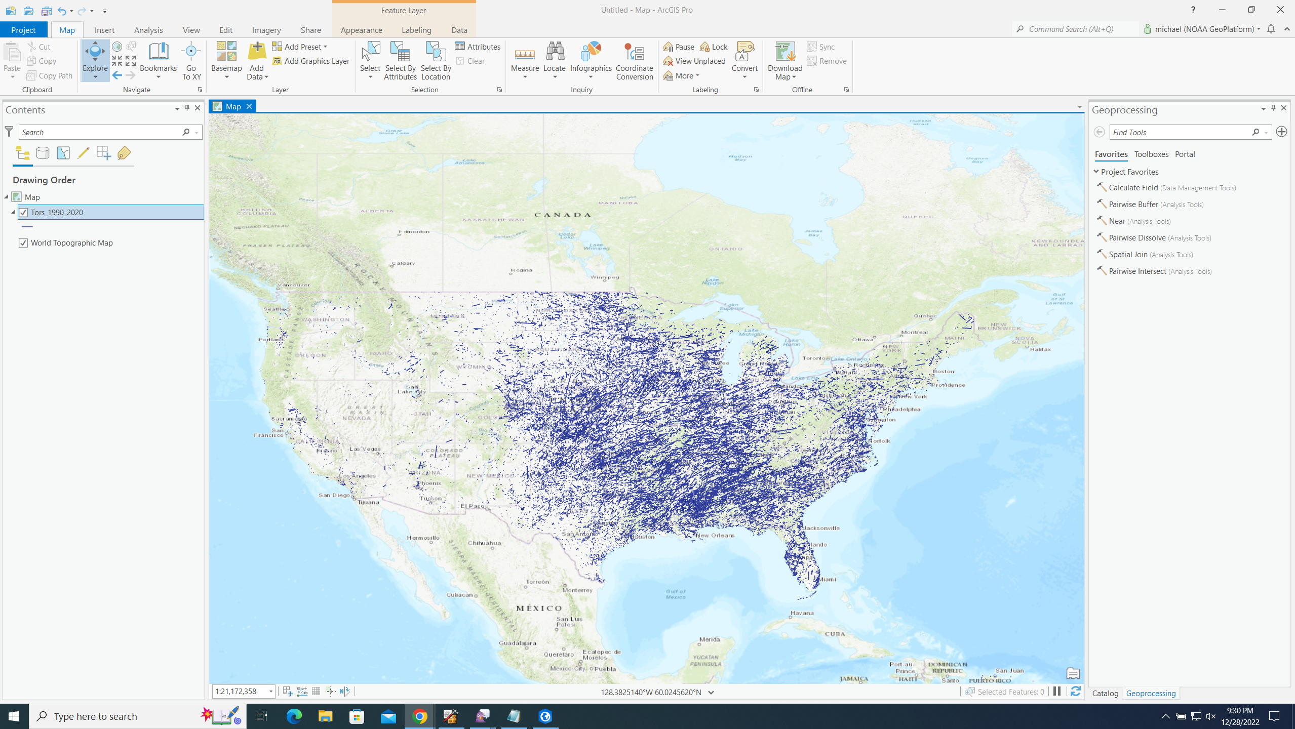

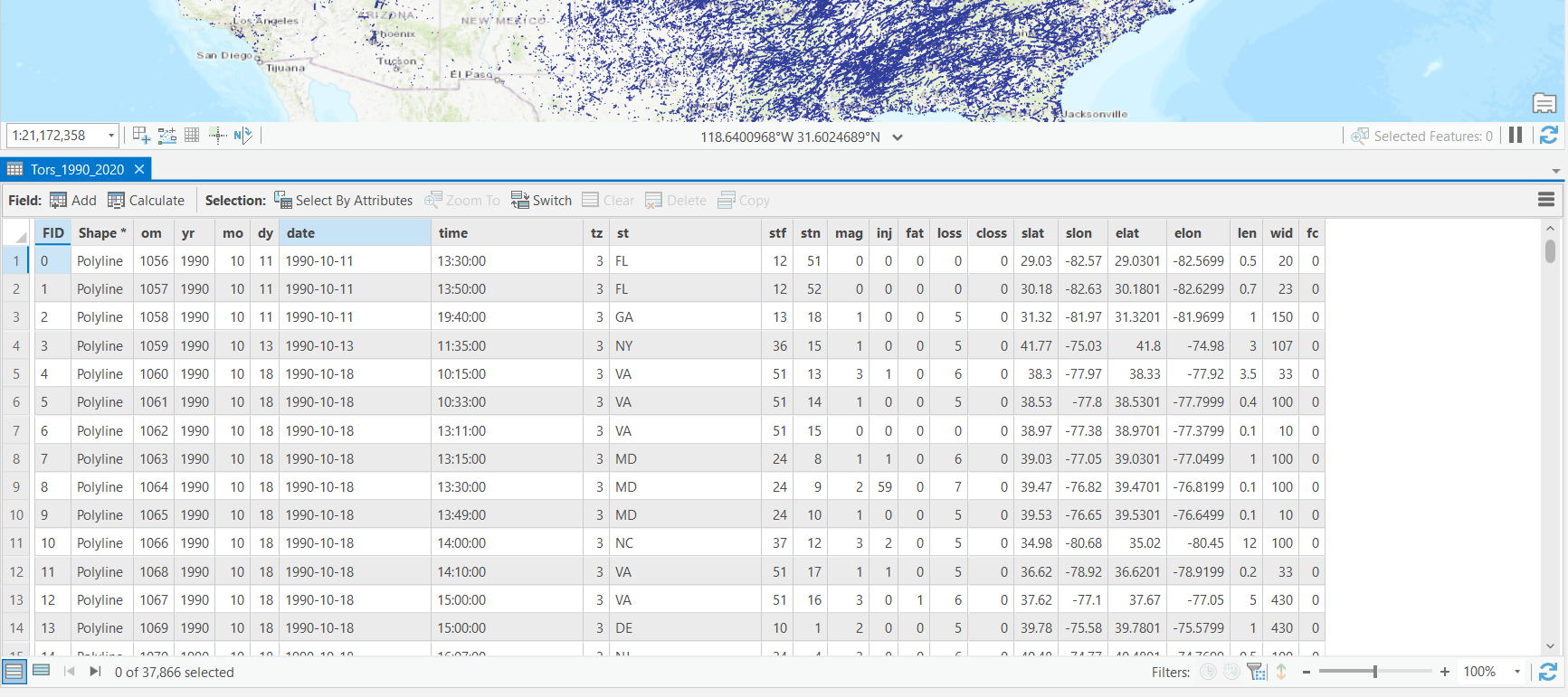

I noticed that the map illustrates the mean number of tornado days per year within 25 miles of a point.  I took a few college courses in ArcGIS--many moons ago--so I know the knobology of ArcGIS Pro.  My workflow is rusty, though, and I'm having difficulty performing the spatial analysis.   The vector data I'm working with is a series of polylines.  I've attached a few images of my data below:
Can anybody give me any hints as to which spatial tools I'm going to need to use to recreate the tornado climatology?

do the polylines represent contours or the path of the tornados?
... sort of retired...
michaelalbano
The polylines represent the path of the tornado.  Alternatively, I have point data that marks the starting point of each tornado -- if you think that would be easier data to work with.
