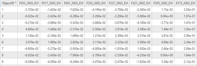

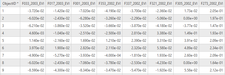

I'm working with ArcGIS Pro 2.8. I have an attribute table whose columns I want to keep in chronological order, but when I try to drag and sort them, they return to their original order. Is there a way to make them keep the order I put them in? As well, is there a way to sort them automatically?
Additional information that might be relevant: these columns were added by intersecting using the geoprocessing tool Extract Multi Values to Points. This was done in multiple batches, one for each year.
Here is a photo of the attribute table in question.

My best solution so far is to enter fields view and sort using that, as discussed here.
https://pro.arcgis.com/en/pro-app/2.7/help/data/geodatabases/overview/an-overview-of-fields.htm
