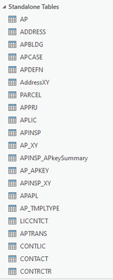

Is there a way to sort the items in the contents pane alphabetically? I have a stack of tables I'd like to order that way:
That should just about do it....

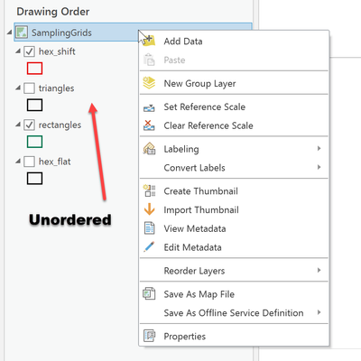

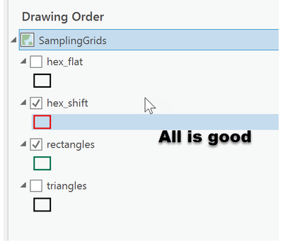

For example... unorder layers in a table of contents, order them
might work for other things... or not

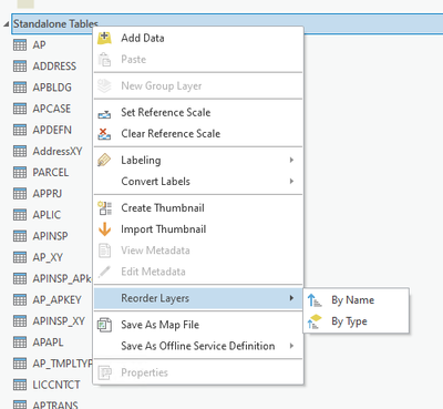

Rats; thought did it, but didn't.  When I right click on Standalone Tables it gives me the choice to reorder layers and that's what it does, but not tables....
