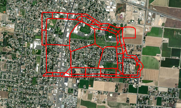

Shapefile coordinate system: NAD83 Stateplane Montana FIPS Feet
Desired coordinate system: NAD83 CSRS UTM 12

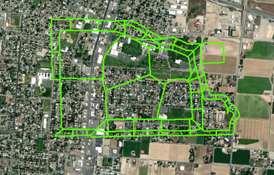

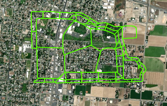

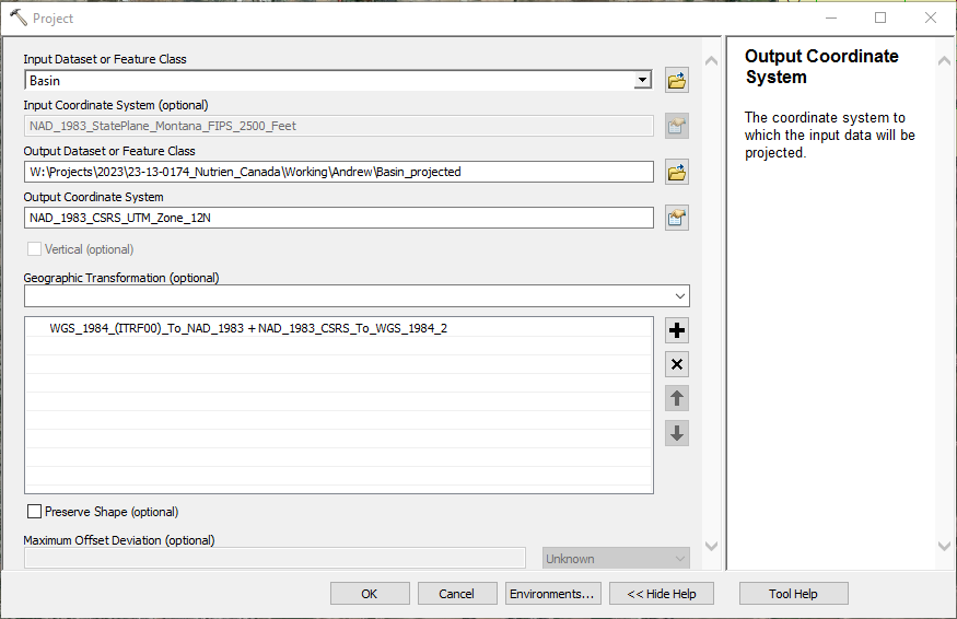

I run "project", and the shapefile is still in the same place. Why? (Red lines are before, green is after)

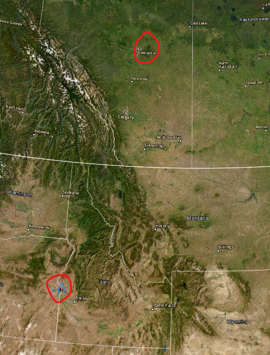

Attached is the current location (Idaho/Oregon), and the desired location (Alberta, Canada)
I believe a client sent us this data as it is currently. Any suggestions are appreciated. Thanks!

Perhaps the file was initially defined using the wrong coordinate system.
it doesn't make sense to use that to define a location in Canada, especially since the vast majority of Canadian spatial references are metric and would use meters rather than feet for the coordinates.
It might be worthwhile calculating the Northing for a few locations in the table and see how they compare to the expected location relative to the equator

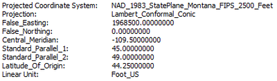

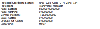

I found this under "properties", if this helps. The second one is a shapefile of the some of the same basins created using archydro in the desired region. The data frame is in Montana State Plane. Thanks!

Projecting a dataset won't change the location of the features. If you think the projection is incorrect, redefine it.
pokkiri
As others have noted, when "Project" doesn't change the data's location, it usually means the source CRS definition is wrong. The Project tool mathematically transforms coordinates assuming the source CRS is correct - if it's wrong, the output will still be wrong.
The key is figuring out what CRS the data is actually in. For Canadian data, common options include NAD83 CSRS UTM zones or provincial coordinate systems (meters, not feet).
A quick way to diagnose this: upload the shapefile to projectionfinder.com - it will preview your data on a basemap so you can immediately see where it's actually appearing. If it shows up in Idaho/Oregon instead of Alberta, you know https://projectionfinder.comthe defined CRS is incorrect. The tool can also suggest likely projections based on the coordinate ranges.
Once you identify the correct source CRS, use "Define Projection" to fix the metadata, then "Project" will work correctly.
