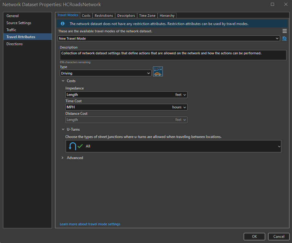

I do have a network built for my area using our county road layer, but I don't know how to set up the travel modes and associated cost settings in the network dataset properties. I previously did a service area by distance for another analysis and it would not perform a calculation by miles. I had to use feet. I am working in mph. Here's the settings I have tried, but when I go to run the service area it still has ft under Mode in the travel settings group;
Screenshot 2025-04-25 080653.pngScreenshot 2025-04-25 080102.pngScreenshot 2025-04-25 080149.pngScreenshot 2025-04-25 080212.png
