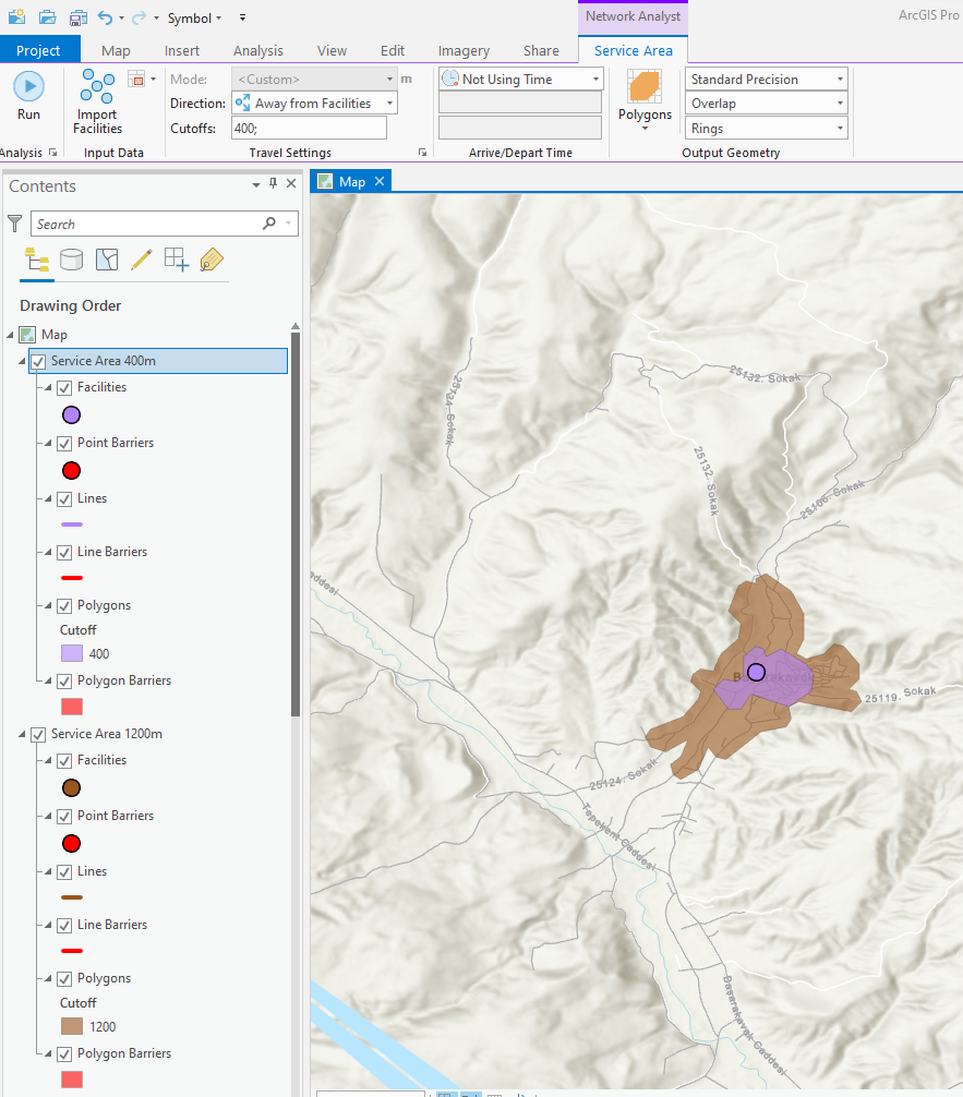

Hi,
I want to create buffers based on the road network around my facilities. I am doing this by service area analysis. I just want to create isochrones based on the network by only entering the distance, not a travel mode. I did it, but there are only travel mode analysis examples on the internet. That's why, I'm not sure about the accuracy of my analysis. Do you know what's the logic behind the service area analysis without selecting travel mode, just entering the distance as in the photo I shared?
Any support is appreciated.
1 Reply
DavidPike
MVP Notable Contributor
Sure, the Purple represents an area traversable along any road segment (from your point of origin) up to 400m, the Brown for 1200m.
You can test this by simply measuring the shortest network distance (follow the most direct road route) from your source to the edge of the purple or brown.  That origin to South-West route looks the simplest to measure.
