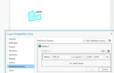

  1. Definition queries-- This will filter your data (using a straight-forward UI or custom SQL) so only data from that one city will show up, period.

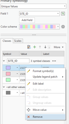

  2. Symbolize by unique value, using the City field, then select the values you don't want and remove them from the symbolization list. (The "<all other values>" patch can also be removed,

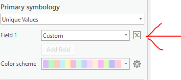

  3. If you want to get fancy, you can use Arcade to just evaluate each record for if it matches an expression. (This is a really simple use of it, it can be a lot more complex depending on your needs)
    1. Open expression editor
    2. Make sure that you're using text values if the field is text, otherwise use numbers.
    3. Each record will be evaluated true or false:
    4. You can then get rid of the ones you don't like (See method 2).
