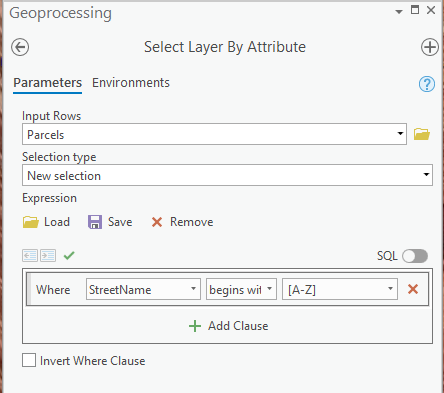

Probably missing something painfully obvious but....
In arc gis pro, I want to select a field where the value begins with A-Z, so I create a clause like this:

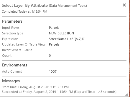

but the results look like this:
I've got street names that start with A-Z as well as 1-9; how do I create an expression that gives me the results I'm after?

JoshuaBixby
MVP Esteemed Contributor
Joe, now I see what you are pointing out.  File geodatabases don't support regular expression features using LIKE, you have to use SIMILAR TO.  See /blogs/tilting/2018/07/19/like-and-similar-file-geodatabases-and-pattern-matching.  What you want in Pro with file geodatabases is:
StreetName SIMILAR TO '[A-Z]%'

JoshuaBixby
JoeBorgione
MVP Emeritus
Good catch.  Completely forgot about that which is how I came to use the less than approach some time ago.  Still amusing none the less: despite Pros advancements, the fgd query limitations remain. Classic example of the more things change, the more they stay the same....
