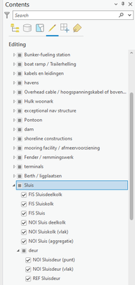

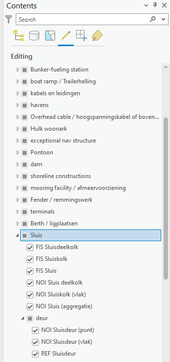

Hello,
I work with large nautical datasets and currently we are working to update our workflow from arcmap to arcgis pro (3.0 and up). During our workflow we like to change selectability and editability of layers on the fly to focus on groups of objects. In the contents-pane you are shown the various groups but you still have expand these to select individual layers (or all with ctrl). Is there a way to change the selection/edit/snapping settings on the group layers? This would make it much better to change the settings on the fly.
Idealy i would like to Ctrl unselect all options (make everything un-editable) and then turn on selection/editing for the select groups i'm currently working on.
