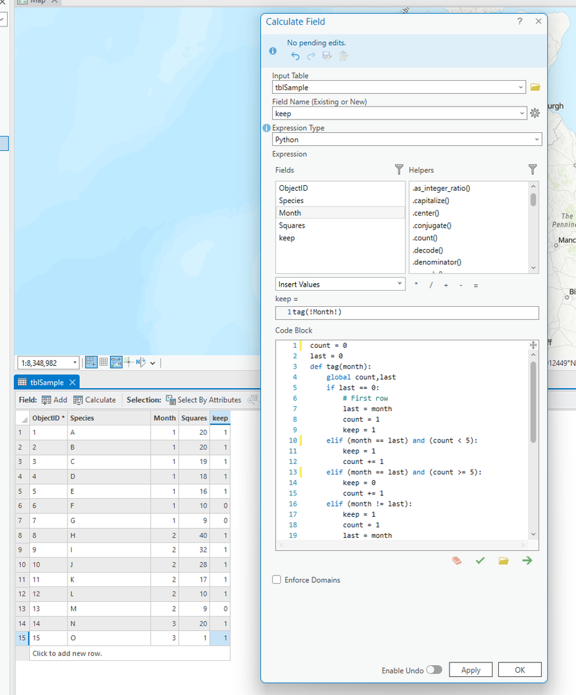

I suspect there are several ways to resolve this and some clever SQL. But this is how I would do it.
  • Firstly the table needs to be a file geodatabase table so you can add a new field. So If your data is in Excel then you need to export it.
  • Add a new field, call it keep and set it to SHORT.
  • The following logic takes advantage of the fact you have pre-sorted the data. Open field Calculate tool and apply the following to keep field.
The code block is:
count = 0
last = 0
def tag(month):
    global count,last
    if last == 0:
        # First row
        last = month
        count = 1
        keep = 1
    elif (month == last) and (count < 5):
        keep = 1
        count += 1
    elif (month == last) and (count >= 5):
        keep = 0
        count += 1
    elif (month != last):
        keep = 1
        count = 1
        last = month
    return keep
  • Now run a simple select by attribute to select rows where keep = 1
  • Export selection to a new table.
