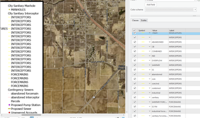

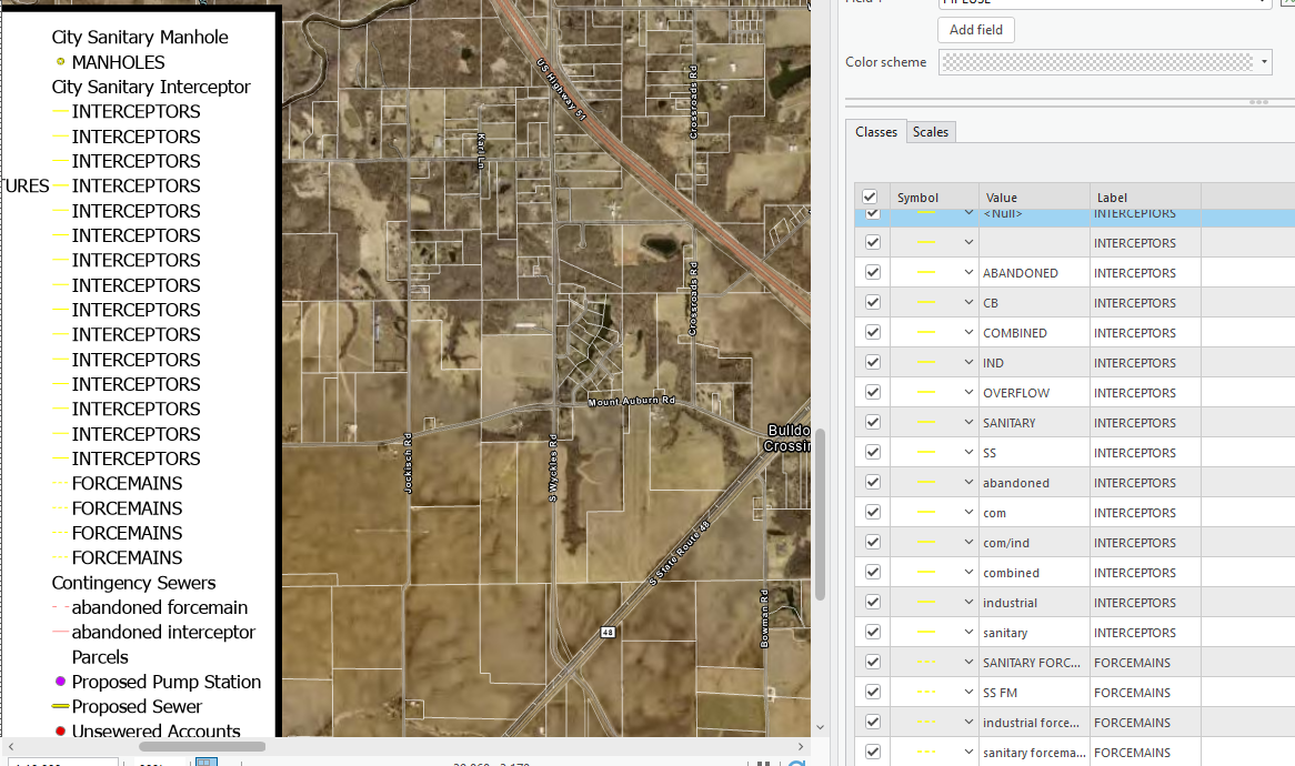

Hi,
I wonder if there is a way (it's been a while) to see if there is a way to eliminate all of the classes, except two that says interceptor and force main instead of having all of the interceptors and force mains in the legend under the "City Sanitary Interceptor". Symbology will not work cause if I uncheck the symbology then there will be a line missing in the map.

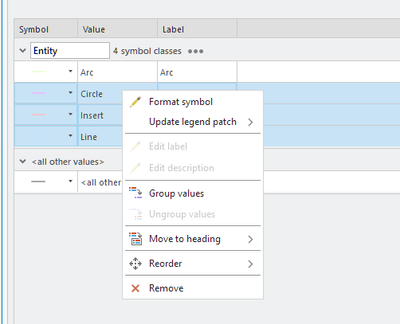

You can select all that you want to show as one value in the symbology and right click, Group Values:

Thank you so much!
