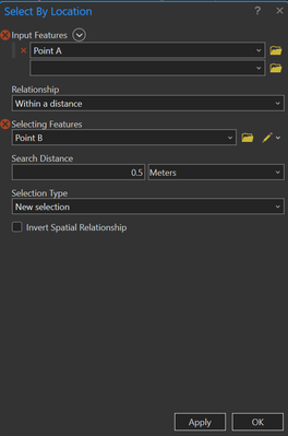

Hi Claudia, if the points A, B and C are three separate layers then may be try "Select by Location" > Input Features = Point A >  Relationship = Within in distance > Selecting Features = Point B > Search Distance = 0.5 Meters
Question | Analyze | Visualize
ClaudiaGiménez
Hi Ed, thank you for your reply. But the points A, B and C are in the same layer.
These points were just an ilustration of what is happening in my layer with 6.000 points. What I want is to eliminate those points (that is contained in one layer) with at a distance of less than 0.5 meters.

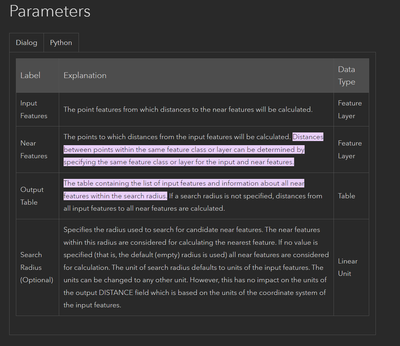

ClaudiaGiménez
Hi Ed, but I don't have that tool, cause it is deprecated. That's why used: Analysis tools > Proximity > Generate Near Table.
Disclaimer, I will attach screenshot a part of my data, so you can see the amount of points.
Also I clicked the option of: "Find the closest feature", but in fact I want to obtain ALL the points that are within 0.5 meters. (And then eliminate them). I know that there is also the option of selecting "Location" in the tool of Generate Near Table, but I don't exatcly know the maximum number of closest matches.
