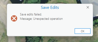

Hi there, I attached the issue I am facing when working in my named created version. Each time I made an edit and validated in Utility Network. The below attached screenshot pop up. Can we please help to find a solution.

Hi @JeremiahGbolagun1  maybe you could have a BUG with your ArcGIS Pro version. You could check these two links and then i think you will solve your error :
  1. https://support.esri.com/en-us/bug/in-a-utility-network-an-edit-fails-when-attempting-to-d-bug-00016...
  2. https://support.esri.com/en-us/bug/in-a-utility-network-an-edit-fails-when-attempting-to-d-bug-00016...

Hello @JeremiahGbolagun1 - Adding on to this, it sounds like we are working with a UN feature service and editing a branch child version. Correct?
  1. What is our UN version, Pro version and Enterprise version?
  2. Is this the only child version having the issue? Are we able to perform similar edits and validate in a different version?
  3. Did we see any additional error messaging in the ArcGIS Server logs (can view in Server Manager)?
  4. Any difference in behavior when validating in the Ribbon vs the GP tool? https://pro.arcgis.com/en/pro-app/latest/tool-reference/utility-networks/validate-network-topology.h...
