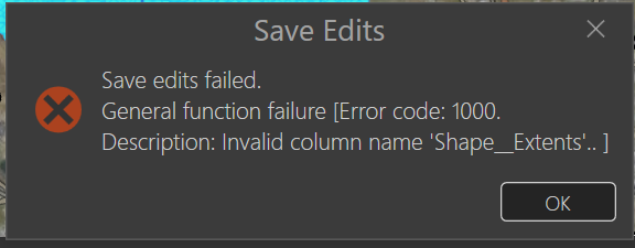

Save edits failed. General function failure [Error code: 1000. Description: Invalid column name 'Shape__Extents'.. ]

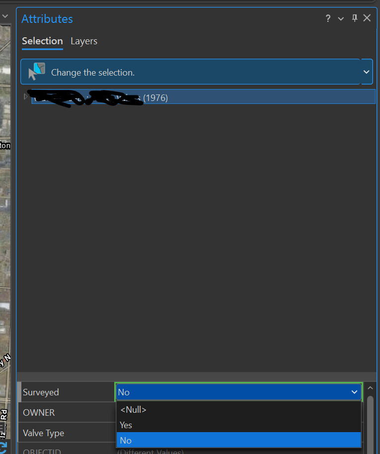

I'm batch editing Hosted Feature Layer attributes in ArcGIS Pro and I receive this Save Edits Error Code. If I select 100-200 maybe more, edit the attributes and click save, I don't receive this error. So to push my edits through, I have to repeat these steps for the rest of the few thousand features to update their attributes.
